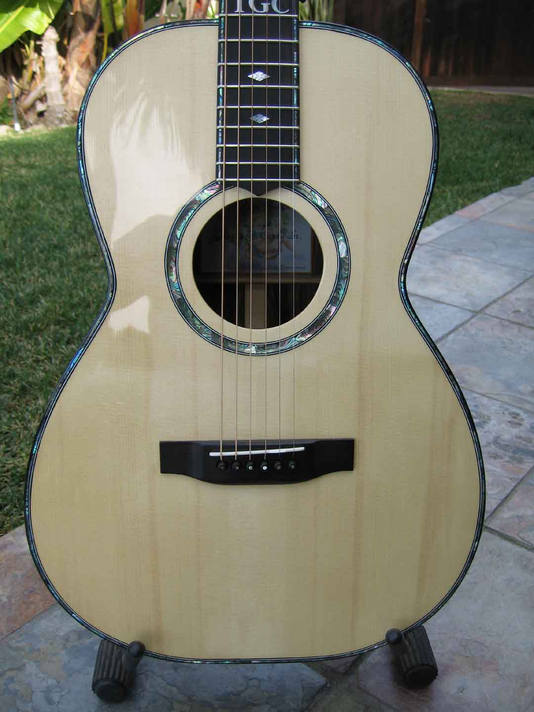

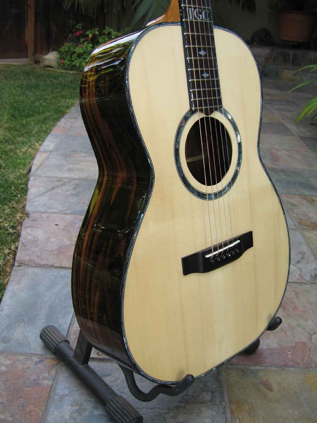

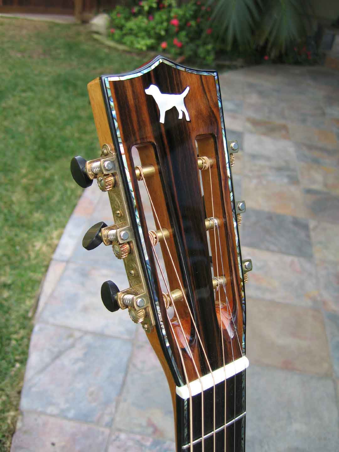

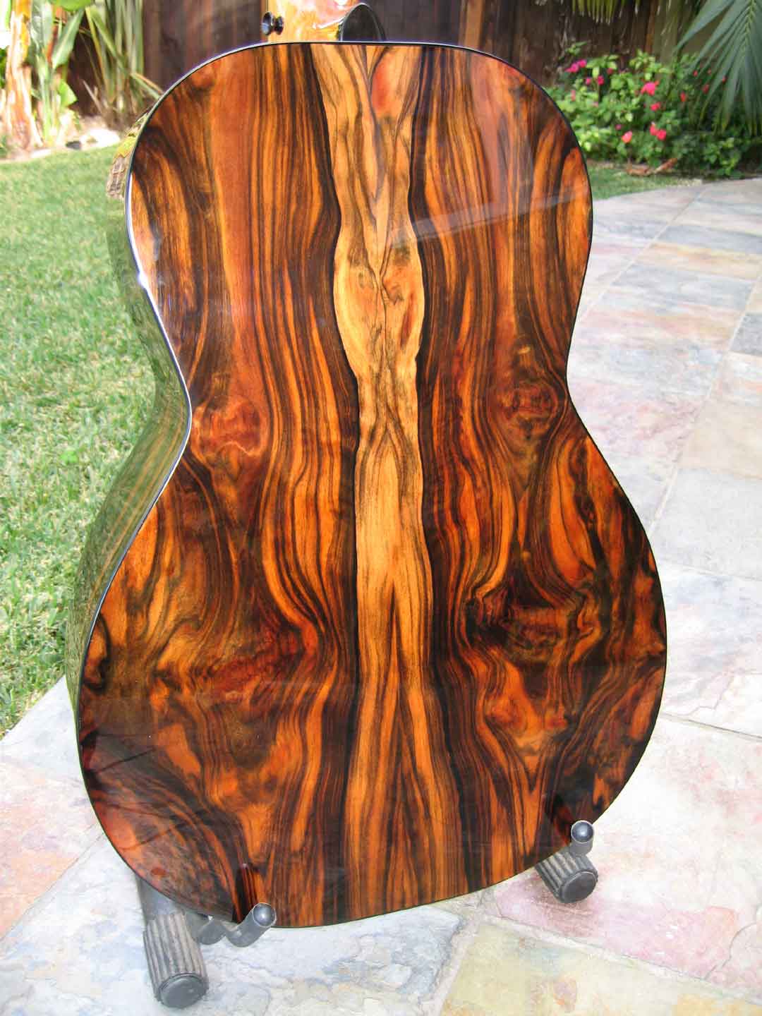

PostPosted: Thu Feb 16, 2006 10:40 am
Thanks again for all of your help.
Here are picts of #5 (commision #2)
000 12 fret Mac Ebony Back and sides.
Adirondack Spruce Top
Waverly Tuners
Lots of abalone
useruploads/azimmer1/2006-02-16_183906_canty2.jpg">useruploa ds/azimmer1/2006-02-16_183927_canty3.jpg">useruploads/azimme r1/2006-02-16_183942_canty4.jpg">useruploads/azimmer1/2006-0 2-16_183958_canty5.jpg">

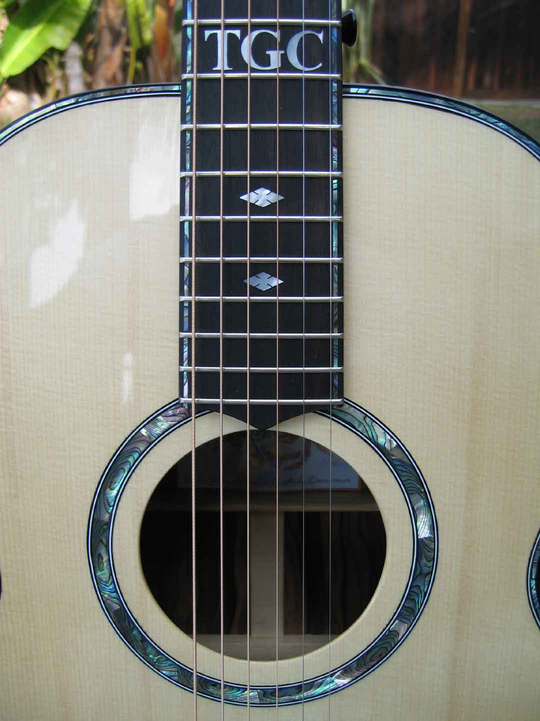

useruploads/azimmer1/2006-02-16_184315_canty5.jpg">
Sorry about the size..now you can see ALL the mistakes

Andy,
Beauty! Nice balance of flash and good taste. It's a real attention getter and I'm sure it sounds just as good as it looks.

Great work love, love the back wood, are in inlays TGC for Taking Gare of Cuissness?

Andy,
That sure is a beauty! You should be proud. What's the binding?
PostPosted: Thu Feb 16, 2006 11:35 am
I love the abalone on the fingerboard--how did you do it? What kind of binding is on the body, I can't tell? It beautiful!!!!
PostPosted: Thu Feb 16, 2006 11:58 am
The answers
TGC are the initials of the person it was built for.
The body binding is boring old black plastic...sorry woodlovers, soon I will
work with wood binding.
As far as the abalone up the fretboard, I bind all my fretboards. (Only an N
of 7) That is the ebony outside the abalone. Real wood not plastic. But, 1st I
routed a channel for the abalone, then bound the board, then inlayed the
pieces between the fret slots.
Thanks for the kind words
Andy

gorgeous wood, great workmanship, nice appointments. Love the tuners, Nice slotted headstock, and wide ab around the soundhole. MMM mmm. It's good.

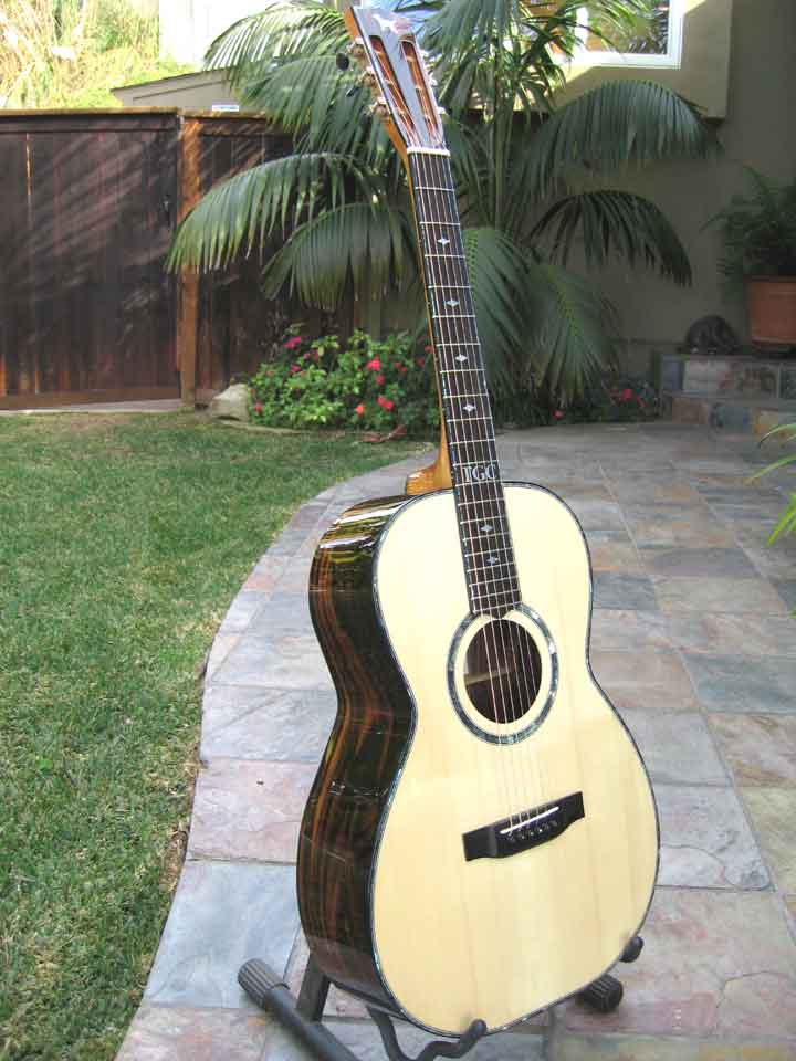

Here is the full guitar...not a good pict
Andy
